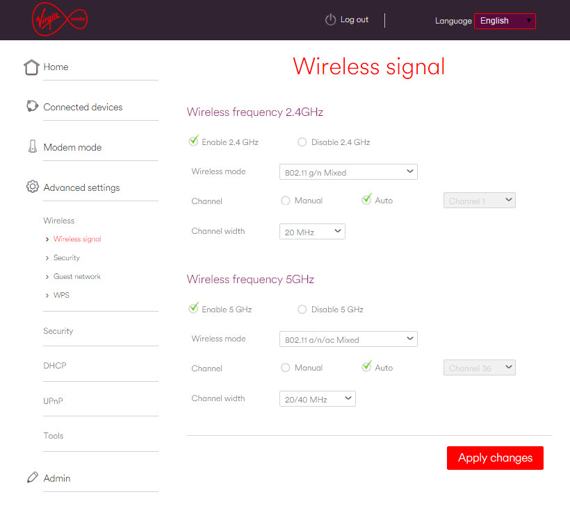

Access the settings page by entering the web address shown on the Hub sticker. For a guide on how to do this, please see Configure Advanced Settings on your Virgin Media Hub
3 icon
Once you have logged in click Advanced settings then Wireless and then Wireless signal.
4 icon
Click the options for Disable 2.4 GHz and Disable 5 GHz.
5 icon
Select Save and then close the browser window.
Any devices on your WiFi network that were connected to the Hub will now be disconnected. The Hub will be unable to accept any WiFi connections until the above process is reversed (re-tick the enable options from Step 4).

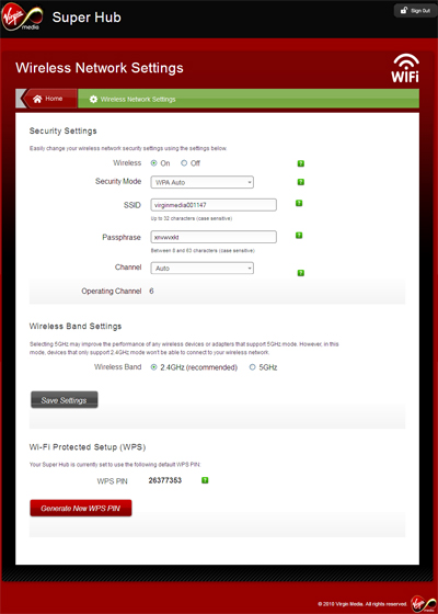

Access the settings page; Enter 192.168.0.1 into the address bar of your browser, the settings page will then load
3 icon
Select Wireless Network Settings
4 icon
At the top of the screen select Wireless Band Settings, then select the boxes next to the 2.4GHz and 5GHz WiFi bands to disable them
5 icon
Any devices on your WiFi network that were connected to the Super Hub will now be disconnected. The Super Hub will be unable to accept any WiFi connections until the above process is reversed (re-tick the boxes from Step 4).

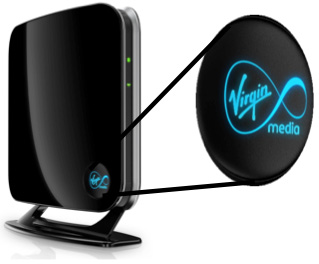

The easiest way to turn off the WiFi signal is by using the Virgin Media button on the front of the Super Hub 1. Press and hold the button for 6 seconds
3 icon
You should now see that the WiFi light on the side panel of the Super Hub 1 is turned off. This confirms that the WiFi signal has been disabled.
