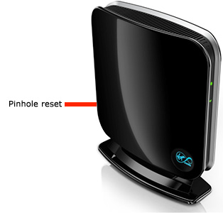

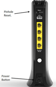

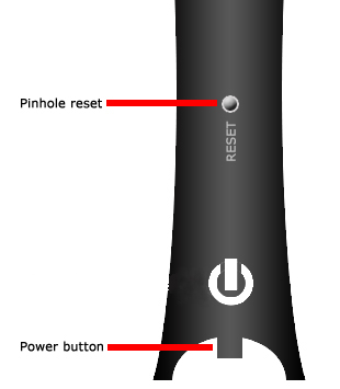

How to reset the Hub?
To factory reset the Virgin Media Hub, follow these steps:
  1. Switch on the Hub at wall socket and at the back of the Hub
  2. On the back or base of the hub, use a pen to press the reset button for 10 seconds
  3. Give the Hub a few minutes to reboot
  4. It’ll be ready when the white power light at the front of the is solidly lit
