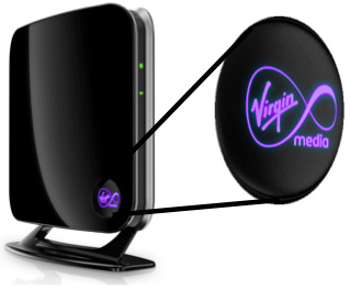

It’ll be ready when the white power light at the front of the is solidly lit

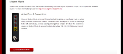

Select Super Hub

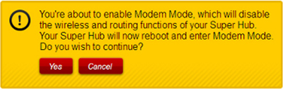

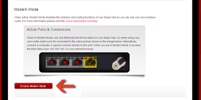

Select Modem Mode
Select Enable Modem Mode
Select Apply Changes

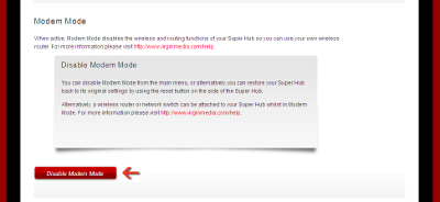

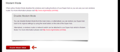

Select Hub Settings
Select Modem Mode
Select Enable Router Mode or Disable Modem Mode
Select Apply Changes. The Hub will reboot and return to router mode.
