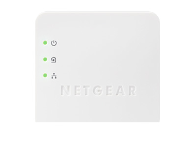

Setting up Ethernet Powerline
Step 1:
Plug one of your powerline adapters into a wall socket near your Super Hub. Then connect your Super Hub to your adapter by using one of the Ethernet cables that came with your kit.
Step 2:
Turn the power on and both the ‘Power’ and ‘Ethernet’ LED lights should come on.
Step 3:
Now plug a second powerline adapter into a different socket in the same room. Use an Ethernet cable to connect the new powerline adapter to your device (computer, laptop or games console, for example.)
Step 4:
Wait for the new powerline adapter to be recognised by the powerline network. The ‘Power’, ‘Ethernet’ and ‘Powerline’ LED lights should come on. This can take up to a minute.
Step 5:
You should now be online! Give it a test by loading a web page on your device or starting a game or app.
Step 6:
We recommend that you secure your powerline network. To do this, press the ‘Security’ button on one of your powerline adapters for two seconds – the ‘Power’ LED light will flash when you release the button. Now press the ‘Security’ button on the other powerline adapter for two seconds. This must be done within two minutes of pressing the ‘Security’ button on the first adapter.
Find out more about powerline security
Step 7:
You can now move the second powerline adapter to the room where you want to connect your device(s). If you want to add additional powerline adapters just follow Step 3 onwards for each new adapter.
