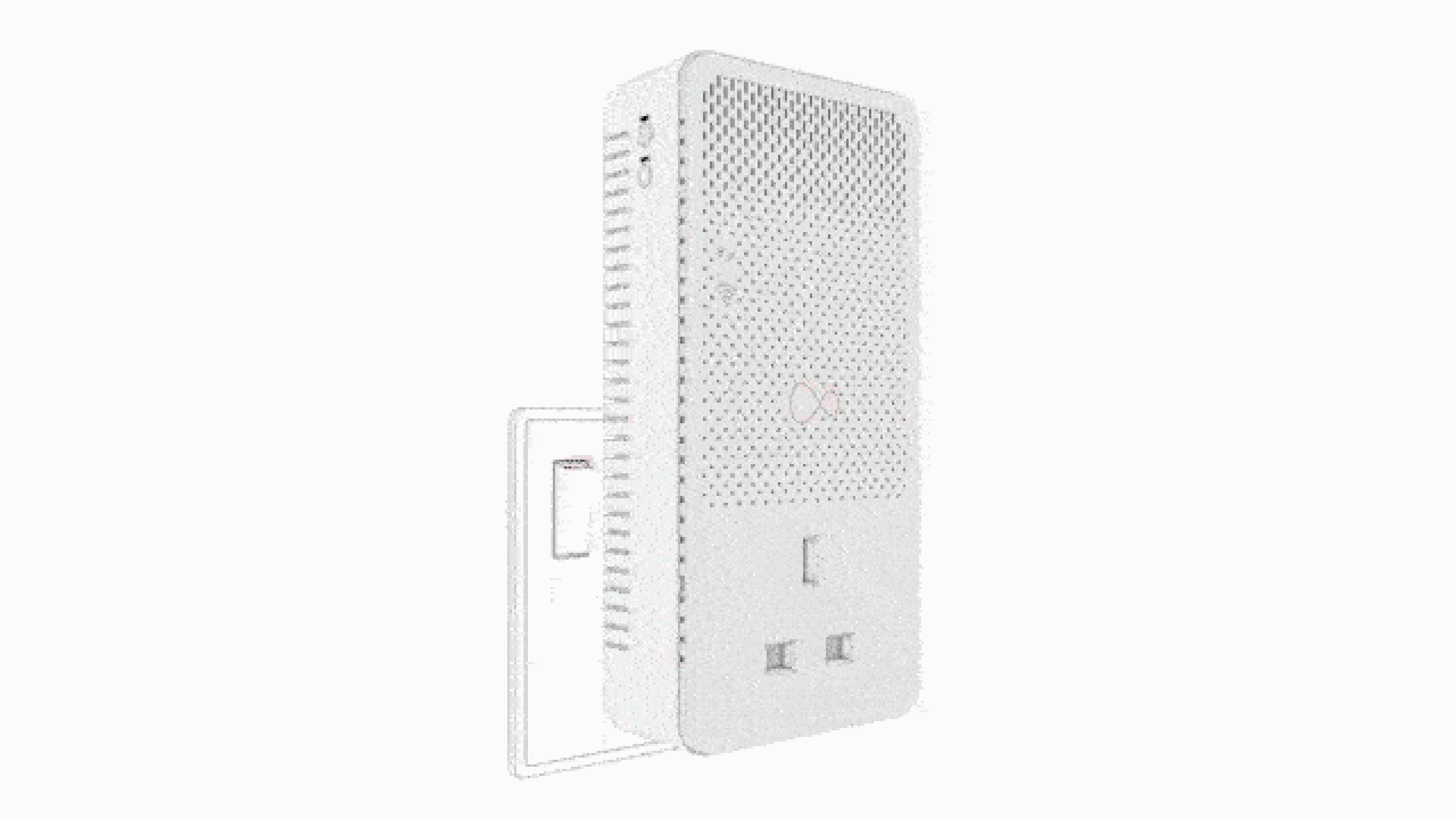

Setting up your first Booster
Follow these simple instructions to install the Booster. Or, take a look at our installation guide

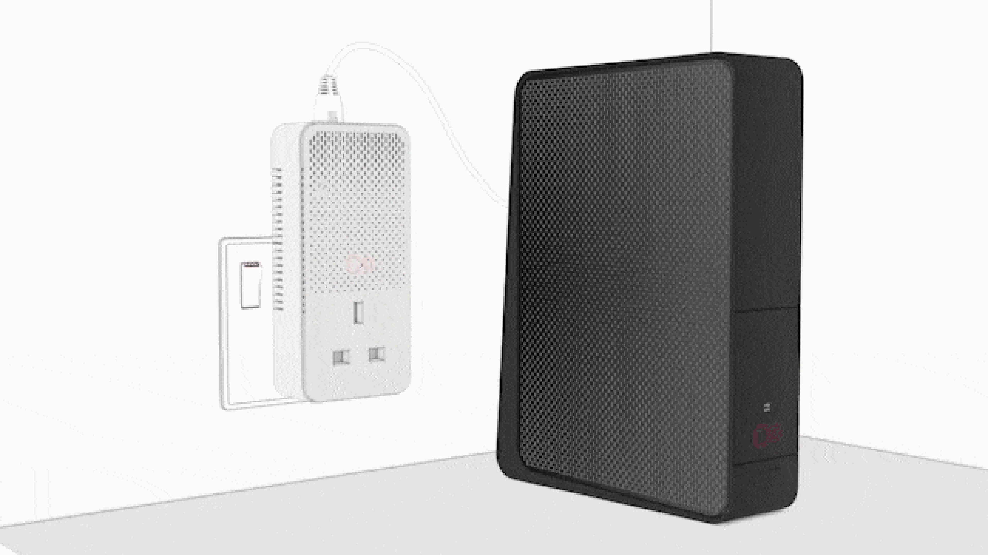

There are two Boosters in your pack. Take the smaller one first and plug it into a mains socket, next to the Hub. After the lights have flashed on, connect the Booster to the Hub, using the Ethernet cable provided.
Note: Make sure you plug the Booster directly into a mains socket, not an extention lead, power strip or surge protector.
Plug the larger Booster into a mains socket, in the same room, and switch it on. Leave for around 15 minutes to pair up to the smaller Booster and download the latest software updates.

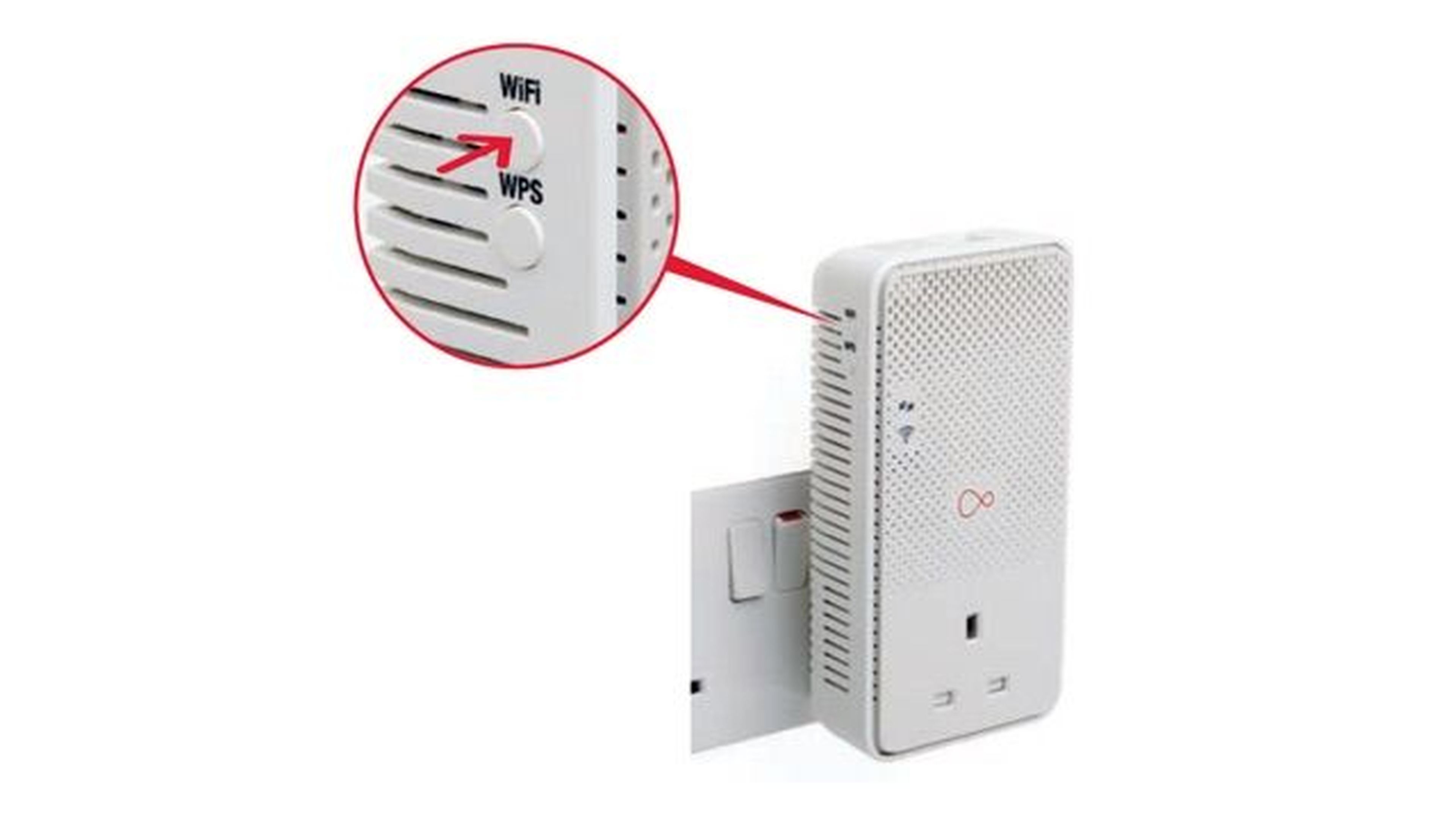

Press and hold the WPS button on the larger Booster for about 10 seconds and release it. The wireless and power lights will start to blink.

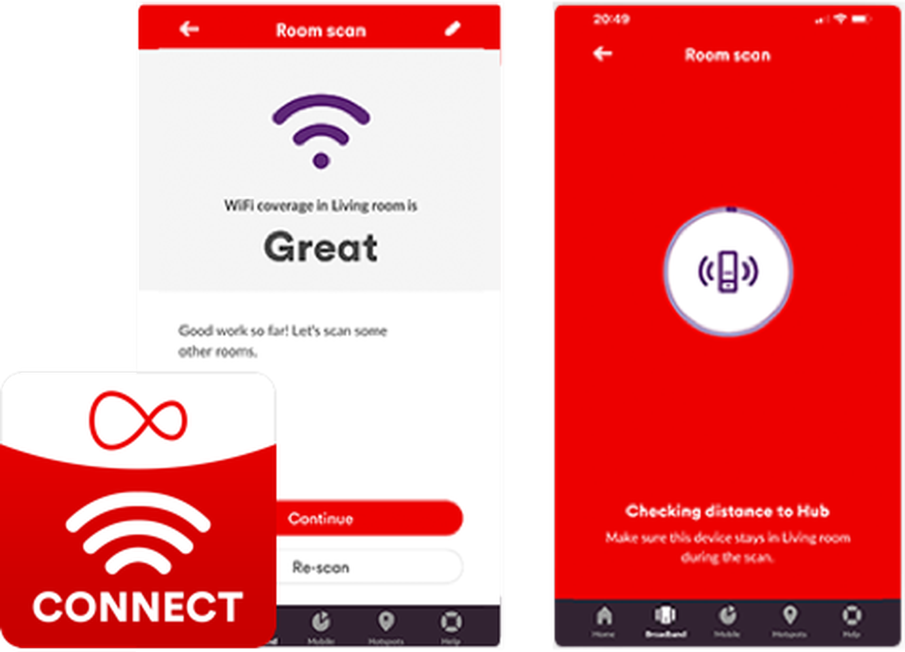

You can use the Virgin Media Connect app to scan your home and smooth out any snags.

Make sure you haven’t pressed the WiFi button on the side of the Booster, as this turns the WiFi on and off.
