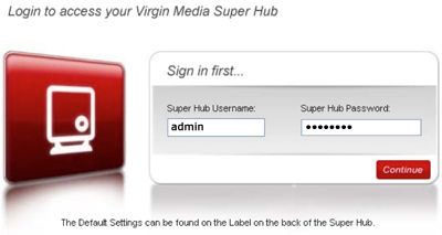

In this section, you’ll be able to get help on how to access your WiFi settings from your browser. Once you’ve logged into the settings page you’ll also be able to configure your WiFi name (SSID), change your WiFi password, run diagnostic tests on the Hub – and setup or modify your Guest network settings.

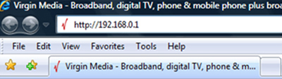

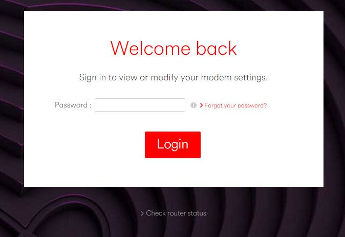

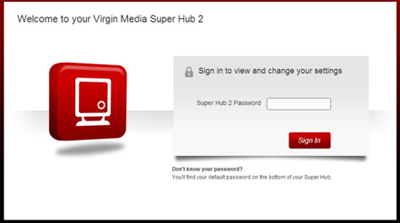

  1. Enter 192.168.0.1 into the address bar of your browser, the settings page will then load. If you’ve enabled Modem Mode on the Hub you’ll need to use 192.168.100.1 instead.
  2. When prompted, enter the settings password shown on the bottom of the Hub/Super Hub.
Once you’ve accessed the page, there are a variety of settings you can change:
  1. Select Advanced settings on the left-hand side.
  2. Select Wireless.
  3. Select Security.
    You’ll then be able to change your WiFi network names and password.
  4. Select Apply changes to save.
