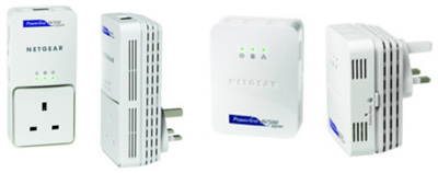

You will see that your Powerline adapters look a lot like ordinary plugs, the obvious difference being the lights on the back that tell you what the adapter is doing. The lights indicate Power Pick a Plug  , Ethernet .
There are also buttons for setting up security and resetting the adapters, we will come to these later.

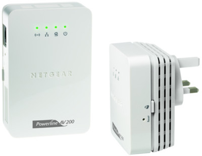

You will see that your Powerline adapters look a lot like ordinary plugs, the obvious difference being the lights on the back that tell you what the adapter is doing. The lights indicate Power Pick a Plug  , Ethernet . On the Wireless adapter, there is also a Wireless light

Powerline 500 + WiFi XAVB5201
You will see that your Powerline adapters look a lot like ordinary plugs, the obvious difference being the lights on the back that tell you what the adapter is doing. The lights indicate Power, Pick a Plug, Ethernet, and are identified by small icons. Wireless adapters also have a Wireless light.
Setting up a Wireless Powerline network is simple, and has steps to make the wireless from your Powerline adapter secure. Carefully read instructions from your manufacturer and check the steps below:
  1. Plug the wired Powerline adapter into a wall socket near your Virgin Media Hub. This will be adapter without the Wireless light. Then connect the Virgin Media Hub to your adapter with one of the Ethernet cables that came with your kit
  2. Turn on the power to your adapter and both the Power and Ethernet lights should come on
  3. Plug your wireless Powerline adapter into another wall socket in the same room, or in a room within wireless range of the Hub and check the Power light on the adapter is green
  4. Press and hold the Security button on your wireless Powerline adapter until the Wireless light starts flashing, this usually takes less than ten seconds
5. Now for the step to make your wireless secure: press and hold the WPS button on your Virgin Media Hub – and it will flash. On the SuperHub 1 this is the one with the Virgin Media logo, on the SuperHub 2 and 2ac it says WPS, and on the Hub 3.0 it says Pair WPS. Do not hold for longer than two seconds. If the light goes out, press the WPS button until it comes back on
6. Your devices will now connect to your wireless Powerline adapter using your existing wireless settings! Move the wireless Powerline adapter to the room where you want to connect your wireless devices
7. To check you have made your Wireless Powerline secure, we recommend you install on your home computer any Powerline utility that comes with the adapters. This will help you check the security settings of your Powerline Wireless Adapter
